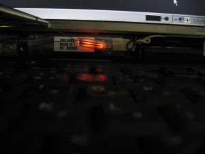

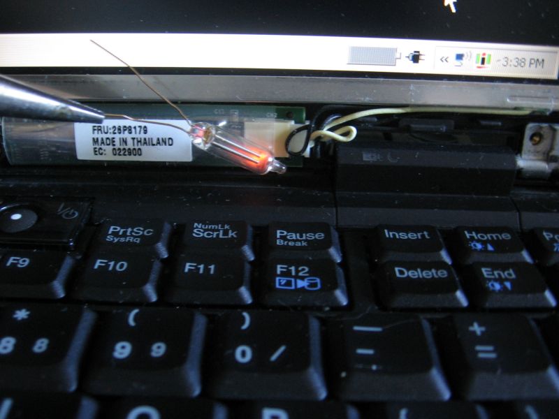

- With the laptop on, hold the neon bulb with some insulated pliers up against the inverter board near where the connector is for the lamp. If it is working, you should see this:
Image 56KB picture
Image 37KB picture
This experiment was done on an X24 system. I have not verified this procedure with any other system at the moment but I do have plans to check it out on a T23 later.
If the neon lamp lights up, then everything up to, and including the inverter board is properly working. That just leaves the CCFL as the problem. If the neon lamp doesn't light up, then there still can be several reasons: the inverter is dead, the ribbon cable is broken or disconnected somewhere or there's a motherboard problem.
Note: I tried holding the lamp up against the X24 and T23 LCD bezels but could not see it glowing. Only when the lamp is almost in direct contact with the inverter board or the wires running to the CCFL, did it light up. This may be due to the age of the lamp I am using (at least 30 years old; a leftover from my days playing around with tube radios and TVs).

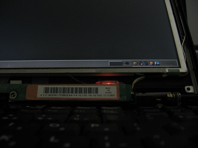

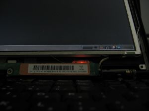

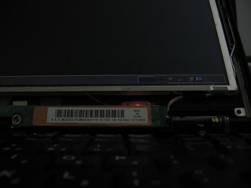

Good question. Yes, the brightness of the neon lamp is directly proportional to the brightness control. Here's two pictures from a T23:
Image Bright setting (40KB)
Image Dim setting (34KB)
Camera exposures were identical between the two shots. You may also notice that I had to put the neon lamp on top of the inverter since the PC board has a copper shield and blocks the RF from the output coil. The only place I could get the lamp to light up on the side facing out is right at the end of the inverter board, next to the jack for the CCFL connector, but it was fairly dim. Again, it could be due to the age of the bulb I'm using. I'll try to get another one sometime this week.
